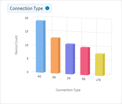

Connection Type
This chart shows devices categorized by connection type. Select a segment to analyze devices with a common connection type.
This chart shows a breakdown of devices based on different connection types of the devices.
How to use this chartUse this chart to identify last location based on whether the device connected via Wi-Fi, 5G, 4G, 3G, LTE or an unknown connection.
CalculationSOTI XSight identifies last location of the device based on the medium the device connects to.

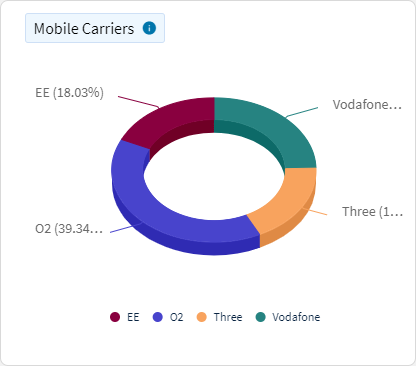

Mobile Carriers
This chart shows device(s) categorized by carrier. Click on the segments to analyze devices with a common carrier
This chart shows a breakdown of devices based on mobile carriers used across devices.
How to use this chartUse this chart to identify last location of devices based on the mobile carrier of the device.
CalculationSOTI XSight identifies the last location of devices based on the connected mobile carriers.

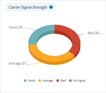

Carrier Signal Strength
This chart shows devices categorized by carrier signal strength. Select a segment to analyze devices with a common signal strength.
This chart shows a breakdown of devices based on carrier signal strength.
How to use this chartUse this chart to identify the signal strength of devices based on their carrier signal strength.
CalculationSOTI XSight identifies last location of devices based on the carrier’s signal strength.
