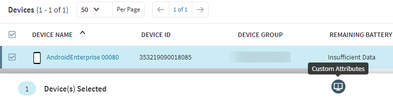

4. Scroll to the Devices table.
5. Check the box beside the device you wish to update. The Custom Attributes button appears for the selected device.

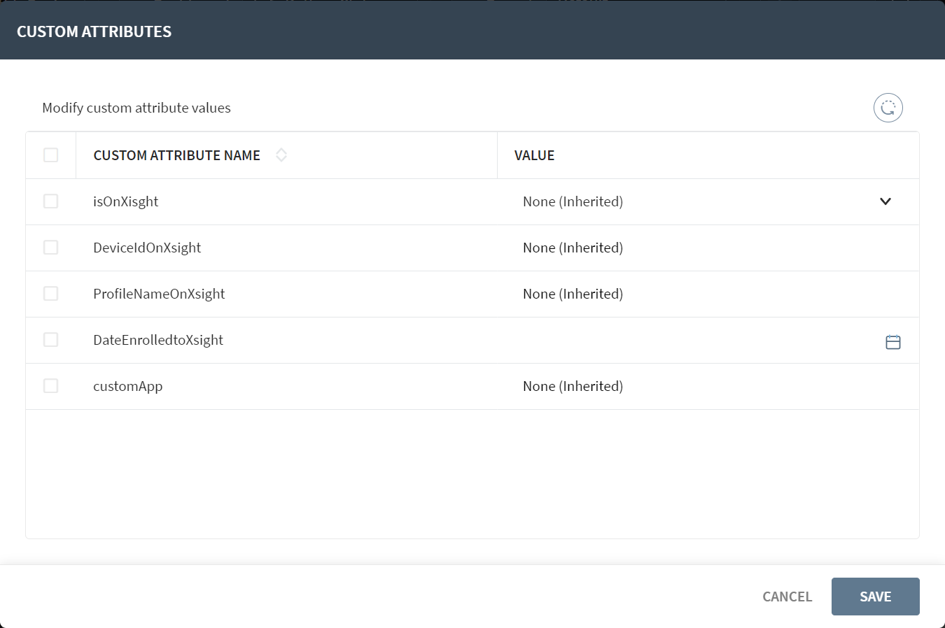

6. Select Custom Attributes. The Custom Attributes window opens.
7. Check the box beside the Custom Attribute Name for each attribute you want to change.
8. Update each selected attribute based on the data type options available under Value. See Custom Attributes in SOTI MobiControl for more information about data types.
9. Select Save.
