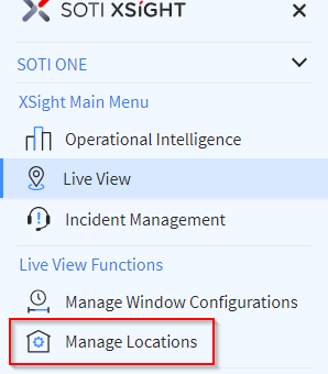

Select Live View from the main menu.
Select Manage Locations from the main menu.
In the Manage Locations panel, select
Locations.

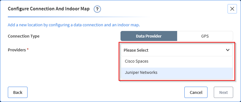

In the Configure Connection And Indoor Map panel, for
the Connection Type:
- Select Data Provider and then select a data provider from the Providers dropdown.
- Select GPS.
If you selected the Data Provider Connection Type, continue with steps 6 through 11.If you selected the GPS Connection Type, continue with steps 12 and 13. -
Connection Type, select a provider from the
Providers dropdown.
