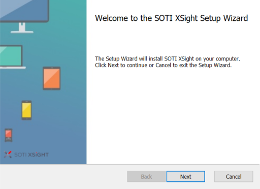

  1. Download the SOTI XSight installer from the downloads section of the SOTI Technical Documentation website. Copy the installer to the server where you want to install SOTI XSight.
  2. Double-click the installer to start it.
    Important: SOTI MobiControl must be running during the installation of SOTI XSight.
    Double-click the installer executable to run it
  3. Select Next.
