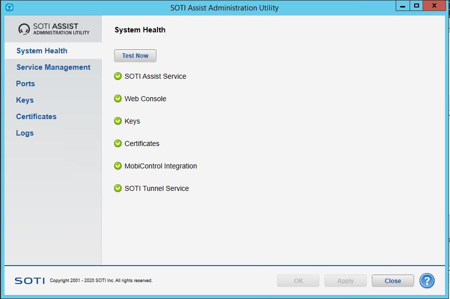

System Health
The System Health panel enables you to see at a glance whether the various parts of the SOTI Assist system are working correctly. If the utility detects a problem with a component, it displays a warning icon next to the component and displays a brief message to indicate the nature of the problem.
SOTI Assist Service Indicates whether the SOTI Assist Windows service is running normally. Click the Test Now button to update the status information.
Web Console Indicates whether the SOTI Assist console is accessible at the configured SOTI Assist server URL.
Keys Indicates whether any problems were found with the RSA keys and encryption.
Certificates Indicates whether any problems were found with the certificate bound to the port SOTI Assist uses for communication.
SOTI MobiControl Integration Indicates whether any problems were found with SOTI Assist's integration with SOTI MobiControl.

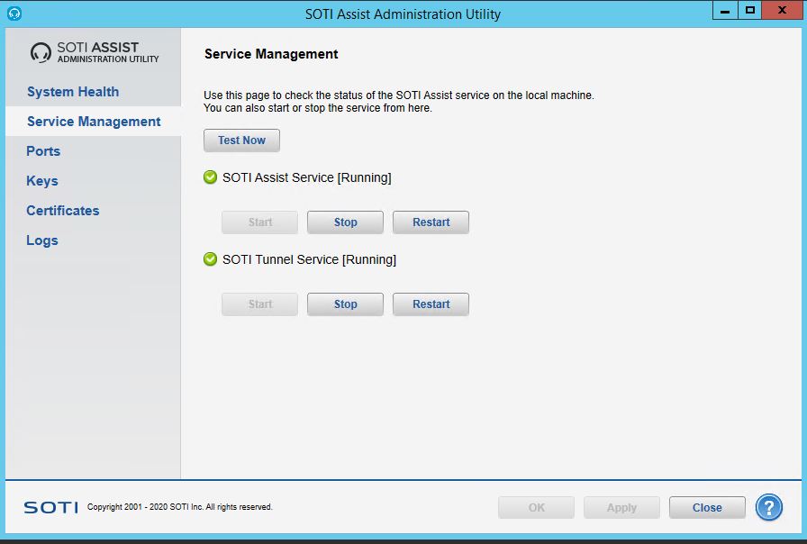

Service Management
The Service Management panel enables you to test the status of the SOTI Assist Windows service on the local machine. You can also use this panel to start, stop or restart the service.
Test Now Tests whether the SOTI Assist Windows service is running normally, and updates the status information according to the test result.
Start Starts the SOTI Assist Windows service.
Stop Stops the SOTI Assist Windows service.
Restart Restarts the SOTI Assist Windows service.

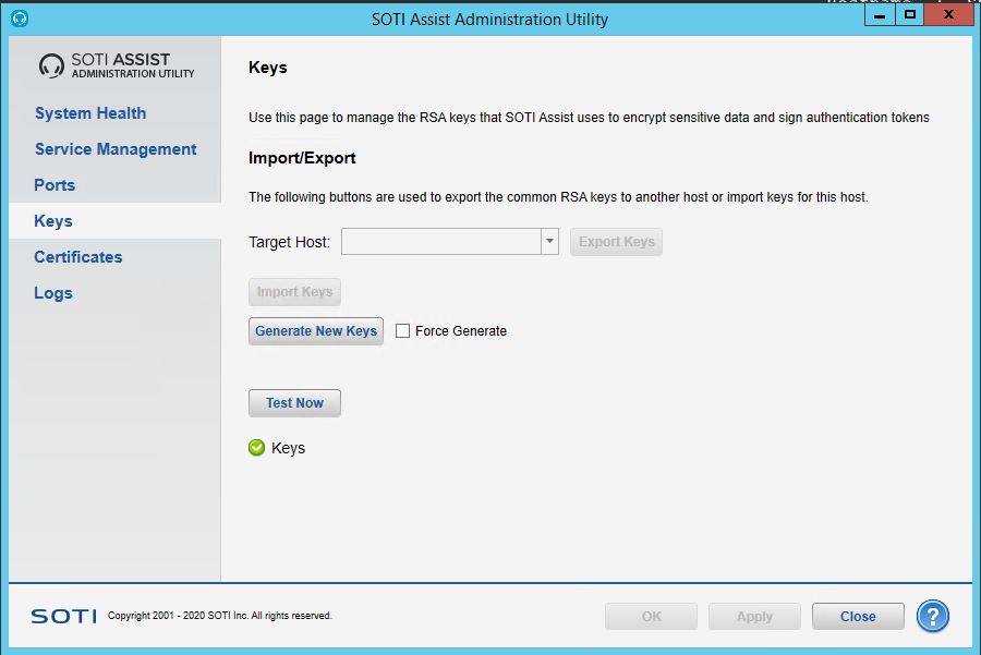

Keys
The Keys panel lets you manage the RSA keys that SOTI Assist uses to encrypt sensitive data and sign authentication tokens.
Target host Select a host from the Target Host dropdown list and click Export Keys to another host.
Import Keys Click to import common RSA keys from another host.
Generate Keys Click to generate new RSA keys if the current keys are compromised. Any existing data will be re-encrypted as part of the key generation process.
Force Generate Enable this option if you want to force key generation even if SOTI Assist is unable to decrypt existing data using old keys.
Note: You may lose data if this option is enabled.
Test Now Click to run an immediate check on RSA keys.

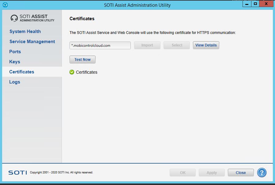

Certificates
The Certificates panel enables you to see, and change, which certificate the SOTI Assist service and console will use for HTTPS communication.
Note: Only one certificate can be bound to a port. If you want to specify a certificate to be used by SOTI Assist only, one that is not shared with SOTI MobiControl, you must do one of the following:
  • Change the port number specified on the Ports panel before you select a SOTI Assist-specific certificate on this panel.
  • Install SOTI Assist on a different machine than SOTI MobiControl.
Import Opens a dialog box in which you can find and select a certificate file you want to import.
Select Opens the certificate store on the local machine, from which you can select a certificate.
View Details Opens the Certificate property sheet for the current certificate, displaying information about the certificate.
Test Now Tests the current certificate for any problems, and displays the test results.
