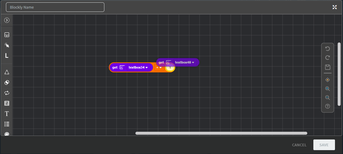

  4. Add the widget values together by dragging each onto the knobs of the Add block. You'll need to grab more Add blocks if you want to add more than two widgets together.
    Adding two widget values together.
