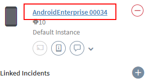

To display the About the Device snapshot page in a separate window, select the device name.
