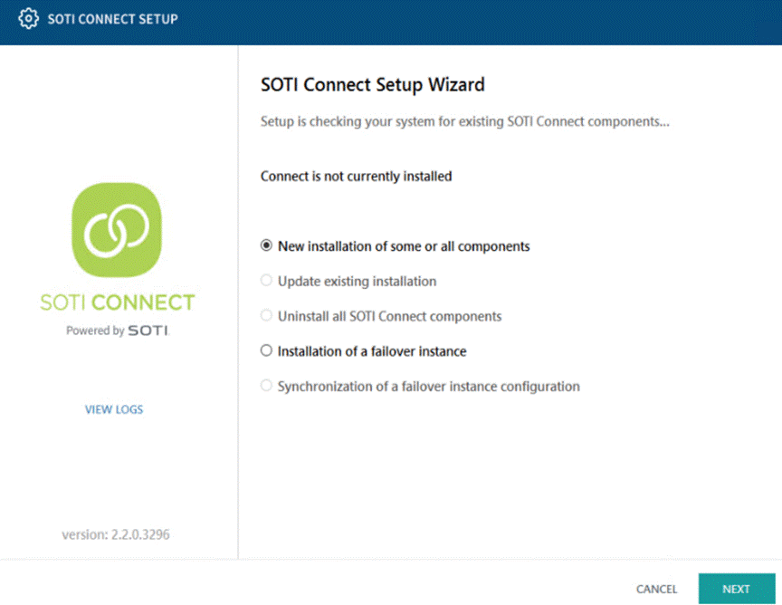

In the remaining steps, we will migrate by adding new PAs to the source PA cluster (Cluster Adapter-0) and removing the source PAs (Adapter-0 and Adapter-2). - To install a PA on RIL-PerfMon27.sotidev.com, run Soti.IoT.Installer.exe. When prompted, confirm that you want to allow the installer to make changes to your system. The SOTI Connect Setup Wizard is displayed.
                Select New installation of some or all components, then
                    click Next. The Installation Type
                    window is displayed.
                Select Custom, then click Next.
