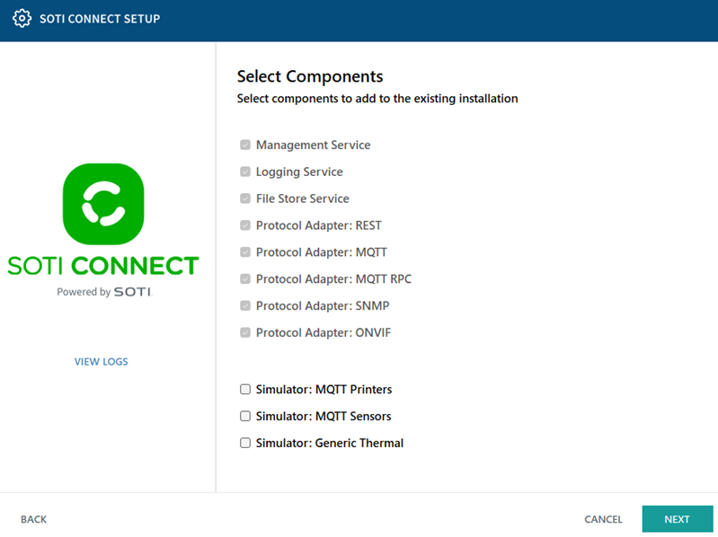

				In the installer, select Add Connect components to the existing
						installation. Select Next.
						Tip: Check that the SOTI Connect Installer is the same as the installed version of SOTI Connect. In the diagram above, the version number of the SOTI Connect Installer (red box on lower left) matches the installed SOTI Connect version (red box on the upper right). -
				On the Select Components screen, choose the components to
					add and select Next.
				Note: Installed components appear selected and greyed out.
 - Follow the instructions in the wizard to complete the process of adding components.
You have successfully added the required SOTI Connect components to an existing installation.
