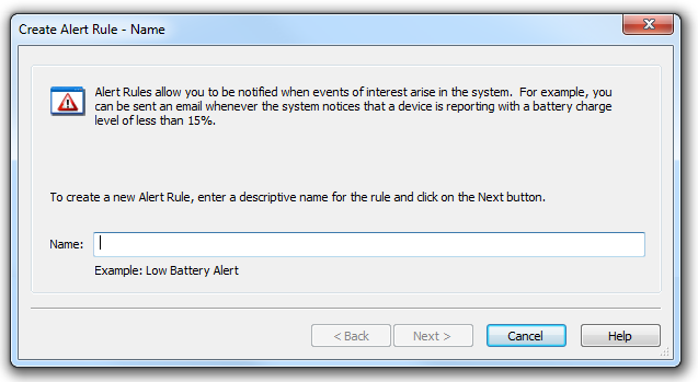

  1. Start the wizard.
    Select the Rules view (tab), then click the Rule menu, select Create Rule, and click Alert Rule. The first page of the Create Alert Rule Wizard will be displayed.
    Enter a descriptive name for the Alert Rule you are creating and click Next.

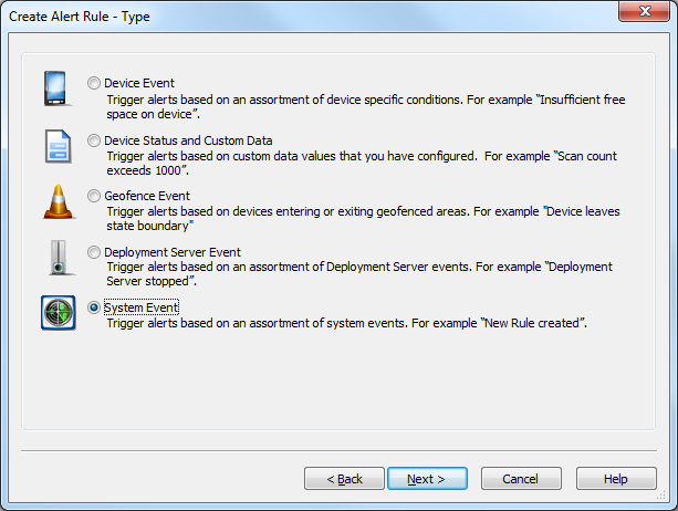

  2. Select the Alert Rule Type.
    Select the Alert Rule Type and click Next.
    TypeDescription
    Device EventTrigger alerts based on an assortment of device specific conditions.
    Device Status and Custom DataTrigger alerts based on Custom Data vales that you have configured.
    Geofence EventTrigger alerts based on devices entering or exiting geofenced areas.
    Deployment Server EventTrigger alerts based on an assortment of Deployment Server events.
    System EventTrigger alerts based on an assortment of system events.

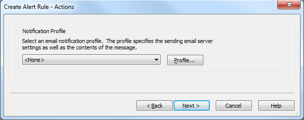

  3. Notification Profile Settings
    Once the Alert Rule is selected, you must select your Notification Profile.
    Select an existing notification profile, or click New to create a new Notification Profile. For assistance with notification profiles click here. Once you have selected your notification profile click Next.

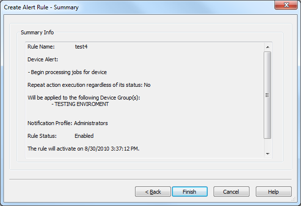

  4. Review the summarized information.
    Click Finish to complete the wizard.
