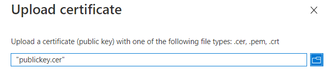

                On the Certificates & secrets page, select Upload
                        certificate.
                In the open dialog, browse to the self-signed certificate generated from
                        SOTI MobiControl.
- Select Save when finished.

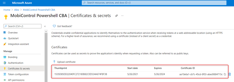

                When complete, select add. The certificate appears in
                    the Certificates section.
- Close the current Certificates & secrets page and then the App registrations page to return to the main https://portal.azure.com/ page.
