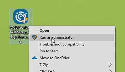

  3. Run the SOTI MobiControl installer as an administrator to launch the installation wizard.

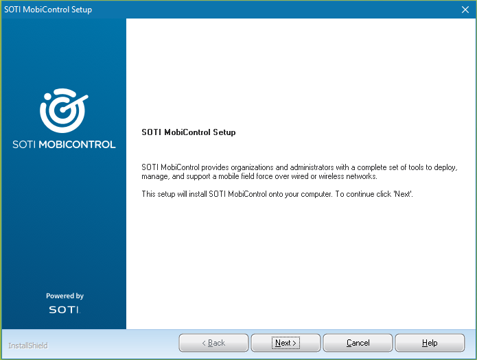

  5. Read the introductory information in the first panel, then click Next.

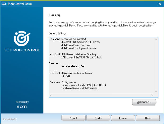

  11. Review your installation settings. Click Next to start the installation, Back to return to a previous wizard panel, or Advanced to access advanced installation settings.
  12. Optional: Modify the advanced settings for SOTI MobiControl. Click Next to begin the installation or Back to return to a previous wizard panel.
    Note: Advanced settings are configured automatically based on the options you chose throughout the installer. Be careful when you modify these options; some may change the default behavior of SOTI MobiControl. Additionally, make a note of any change that you do make for future reference.
