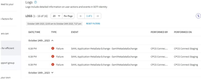

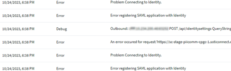

Unable to Connect SOTI Identity with SOTI Connect
While attempting to add SOTI Connect to a SOTI Identity tenant, the following errors occur:
Error in SOTI Connect
SOTI Connect errors
Error in SOTI Identity (v2024.0.1)
SOTI Identity errors
  • Affected versions: SOTI Connect 2024.0 and later.
Issue Resolution
To resolve the issue:
  1. If SOTI Connect is already registered to an instance of SOTI Identity, and you are trying to register with another SOTI Identity tenant.
    • Locate the first connection and delete it from the SOTI Identity console.
  2. Check for certificate issues.
    • For example, an expired or invalid GoDaddy certificate on the SOTI Connect MS server.
  3. Check for the wrong Fully Qualified Domain Name (FQDN) in the SOTI Connect installation.
    • For example, "SotiConnect20" instead of "SotiConnect20.soticonnect.com".
      Note: The FQDN is passed to SOTI Identity and SOTI Identity uses it to call back to SOTI Connect. If the FQDN is wrong, SOTI Identity cannot reach SOTI Connect.
