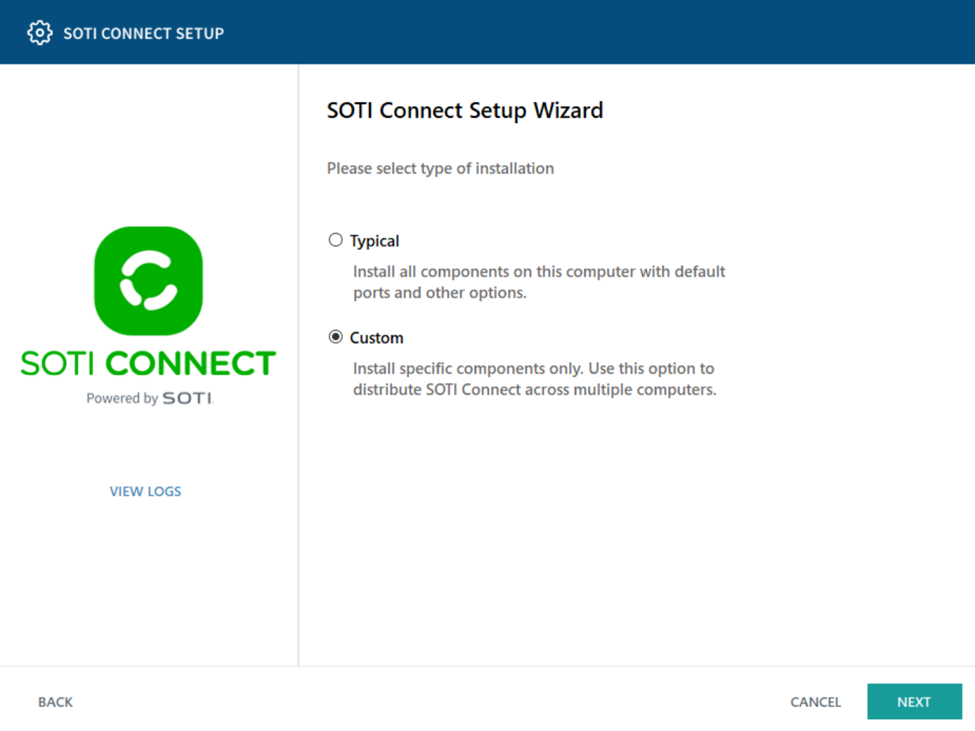

- Run SOTI Connect Installer.exe. The SOTI Connect Setup Wizard is displayed. When prompted, confirm that you want to allow the installer to make changes to your system.
                Select Install Connect components, then select
                        Next. The Installation Type
                    window is displayed.
                Select Custom, then select Next.
                    The Select Components window is displayed.
