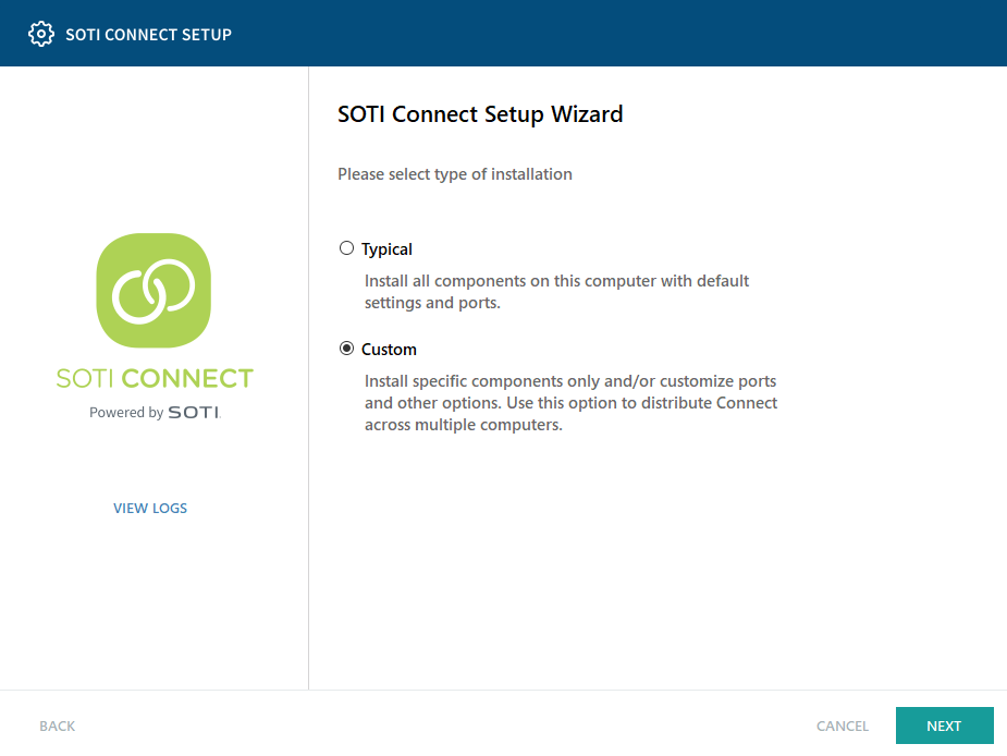

  3. In the installer, select New installation of some or all components, then click Next.
  4. For the installation type select Custom, then click Next.
