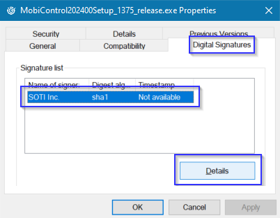

				Validate the integrity of the downloaded installer.
				- Right-click the downloaded installer and select Properties.
- Select the Digital Signatures tab, select SOTI Inc. in the Signature
								list and then select Details.
- In the Digital Signature Details panel, select
								View Certificate.
-  Check that the Certificate status is OK in
							the Certificate panel.

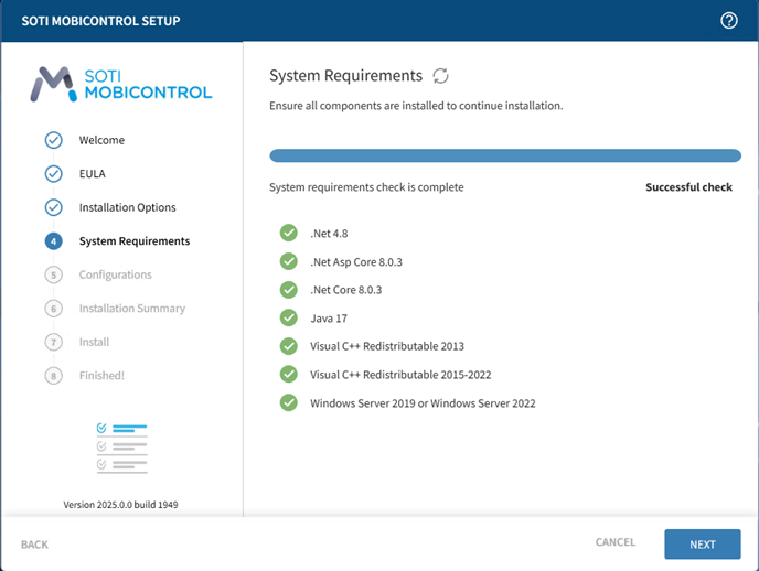

				Ensure all components are installed to continue the installation.
				 Note: If any prerequisite is missing, the installer gives the option to install the missing requirements Note: If any prerequisite is missing, the installer gives the option to install the missing requirements
