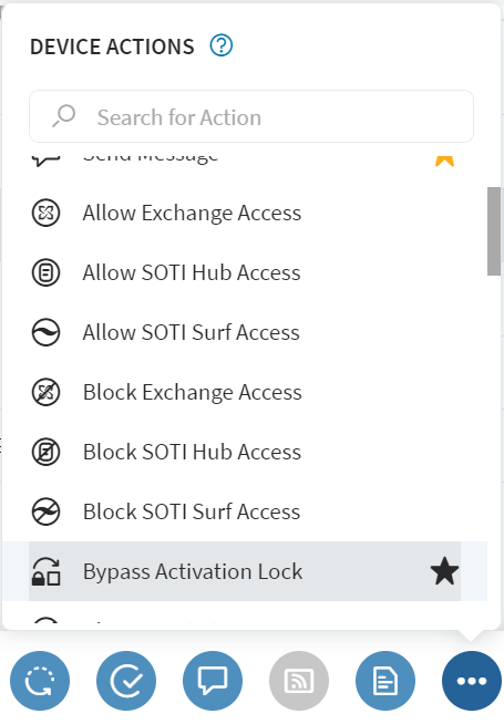

To automatically bypass the Activation Lock on iOS/macOS devices:
Select the devices with Activation Lock enabled, and from the Device
Actions bar, select
icon in the Device Actions menu bar.
- If applicable, select the warning message at the bottom of the dialog box to see why SOTI MobiControl cannot bypass the Activation Lock on some selected devices.
- Select Bypass Activation Lock.
