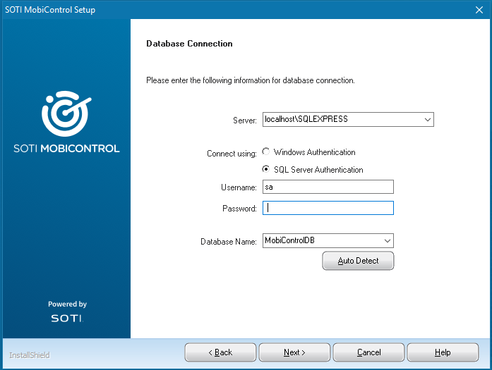

				Enter the information required to connect to your database. Click Next.
				Note: This panel appears only if you opted not to download and install Microsoft SQL Server 2016 Express. See Database Requirements for more information. Server Use the drop-down to select the location of the database on a computer on the network. You can also type in the network location of the database. Note: If your server is configured to listen to a port other than the default (1433), include the port number. For example: SERVER,01234\SQLSERVER .Connect using Select your authentication method: - Windows Authentication
- SQL Server Authentication
 Username Enter the username for the account that SOTI MobiControl will use to access the database. The account must have read/write permissions. Password Enter the password for the account that SOTI MobiControl will use to access the database. Database Name Enter the name of the database. Auto Detect Click this button to retrieve the database name automatically using the provided information to attempt a connection.
