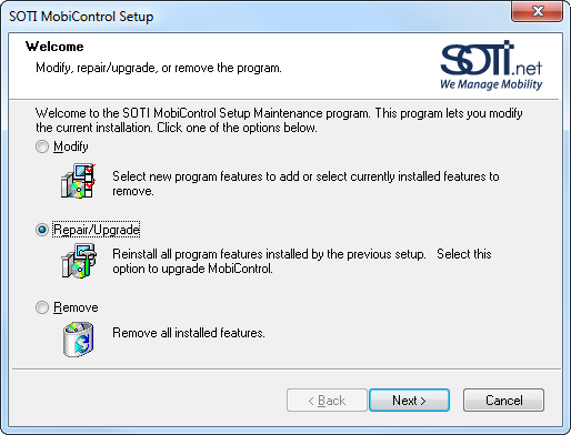

- Run the updated Setup program.
Select the Repair/Upgrade option and follow the setup
instructions in the Setup Wizard. This must be ran on the
Deployment Server prior to updating any of the MobiControl Manager consoles.

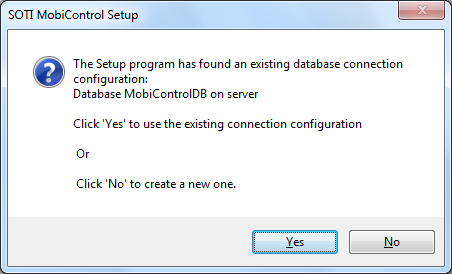

In the dialog box about the existing database connection configuration, select
Yes.

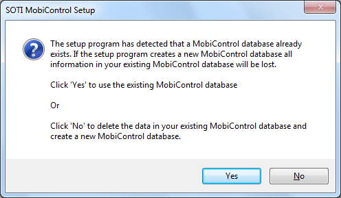

The next dialog box prompts for keeping the old database or getting rid of it and creating a
new one. Since we are upgrading, we want to keep the existing database, so select Yes.

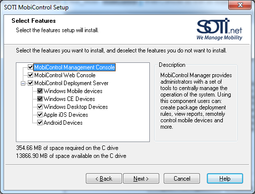

The next dialog box gives you the option to install MobiControl Web Console as well as support for Apple iOS or Google Android Devices.
Note:
To manage Apple iOS Devices, Apple requires an Apple Push Notification Service (APNS) Certificate to be installed. For more information about APNS Certificates please see the APNS Certificate page prior to continuing the upgrade.

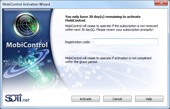

Another dialog box will appear only if you have a registration code that is an older format. To exchange it
and get a new registration code, you must
contact us and provide
your existing registration code followed by the company name and the person to whom the product is licensed.

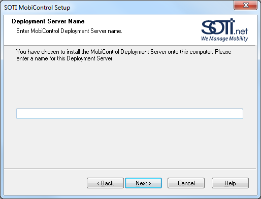

- Enter
Deployment Server information.
A box will be pre-filled with your existing
Deployment Server name. To keep the same name,
select Next.

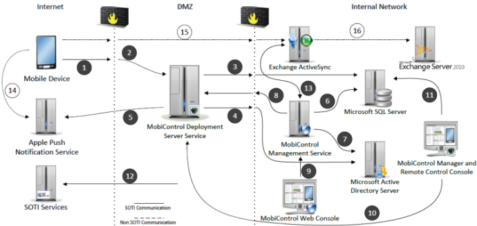

- Network Configuration.
The Network Configuration screen gives you a high level overview of the MobiControl connection architecture.
| # | Network Connection Details | Protocol | Port(s) |
| 1 | MobiControl Device Agent connects to MobiControl Server via firewall/gateway | Binary/HTTPS | 5494/443 | | 2 | Firewall/Gateway port forwards traffic on designated inbound ports to ports on host computer running MobiControl Server | Binary | 5494/443 | | 3 | MobiControl Server connects to Microsoft SQL Server | Binary | 1433 | | 4 | MobiControl Server connects to Microsoft Active Directory Server | LDAPS | 636 | | 5 | MobiControl Server connects to Apple Push Notification Service (APNS) for communication/feedback | Binary | 2196/2195 | | 6 | MobiControl Web Console connects to Microsoft SQL Server | Binary | 1433 | | 7 | MobiControl Web Console connects to Microsoft Active Directory Server | LDAP | 389 | | 8 | MobiControl Management Service connects to MobiControl Server | Binary | 5495/5494 | | 9 | Web browser connects to MobiControl Management Service | HTTP(S) | 443 | | 10 | MobiControl Manager and Remote Control Consoles connect to MobiControl Server | Binary | 5494 | | 11 | MobiControl Manager connects to Microsoft SQL Server | Binary | 1433 | | 12 | MobiControl Manager, Server and Web Console connect to SOTI Services (Activation, Agent Builder, Enrollment, Location, Messaging, Skins) | HTTP(S)/Binary | 443/80 | | 13 | Exchange Filter connects to Exchange Filter Service (running with Management Service) | Binary | 443 | | 14 | Apple iOS devices connect to Apple Push Notification Service (APNS) | Binary | 5223 | | 15 | Device connects to Exchange ActiveSync Server (EAS) to retrieve email | Binary | 443 | | 16 | Exchange ActiveSync Server communicates with Exchange Server | Binary | 443 |
*All communication is TCP based using the protocol outlined above

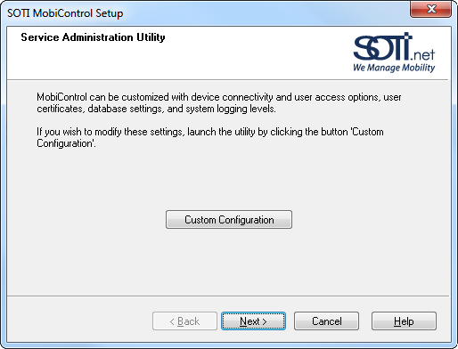

- Custom Configuration
The Custom Configuration button provides access to the MobiControl Administration Utility.

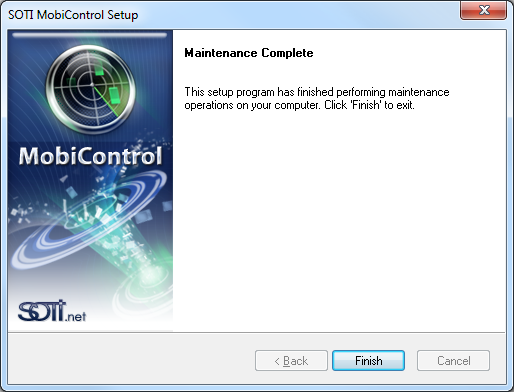

- Complete the Installation.
Repeat steps 4-7 on each computer that has MobiControl Manager,
Package Studio or a Deployment Server installed.

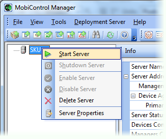

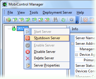

- Verify the Deployment Servers have restarted.
Click the Deployment Servers view (tab) in the
MobiControl Manager to verify the Deployment Servers are active. If a server is not running, you can start it by
right-clicking on the Deployment Server icon and selecting Start Server. If the Deployment Server
is located on a separate host from that on which you are running the MobiControl Manager, you will have to log in
to that host (e.g. Windows Remote Desktop) and re-start the MobiControl Deployment Server by opening the Control Panel, clicking Administrative, and clicking Services.  Re-start Deployment Server(s)

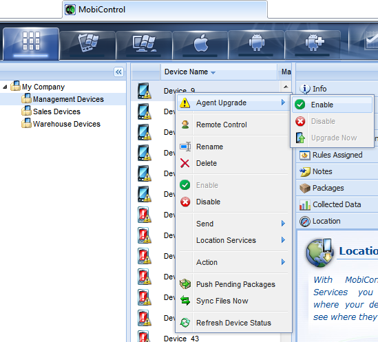

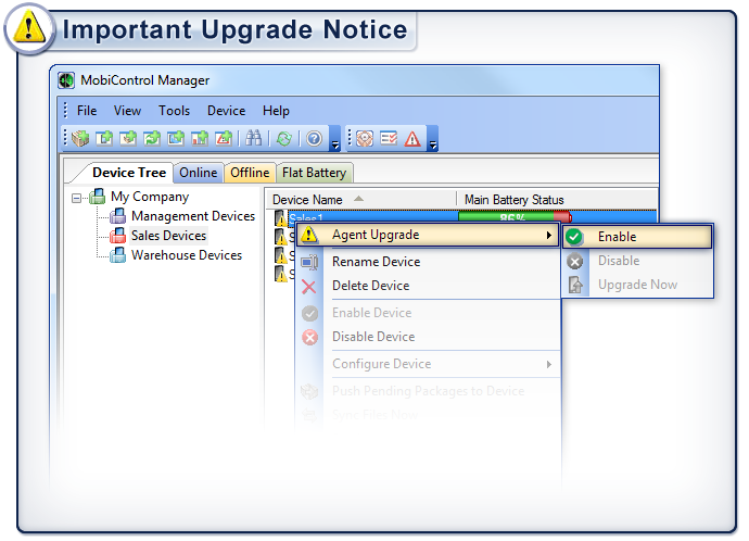

- Enable upgrade for one device.
Right-click on a device, select
Agent Upgrade, and click Enable. If the device is already online, select Upgrade Now. If the device is not yet online, there is
no need to select Upgrade Now, as the new agent will be automatically delivered upon connection to the Deployment Server
when upgrade is enabled.

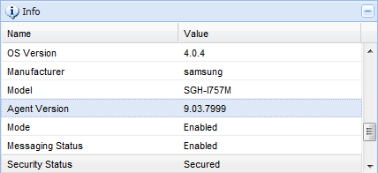

- Verify the build number.
When the device returns online, verify the build number by selecting the device
and looking at the Info panel. If there is any conflict with the version you have installed (compare
to the version information in the Manager's about window), and the version currently on the device, or if there are
any error messages in the log panel, please contact us.
