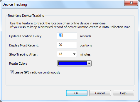

| Feature |
Description |
| Update Location Every |
Set a time interval in seconds (5–86400) for how frequently you would like to have the
device location reported. |
| Display Most Recent |
Choose a value to represent the number of recent
positions (maximum 100) that you would like to see plotted on
the map of the device(s) that you will be tracking. |
| Stop Tracking After |
Set the time interval in minutes (5–
60) for when you would like to end tracking
the device. |
| Route Color |
Identifies the device route you will be tracking |
| Leave GPS radio on continuously |
For faster response time from the GPS
radio on the device, you should enable this check box. The device's GPS radio will constantly be on. |
