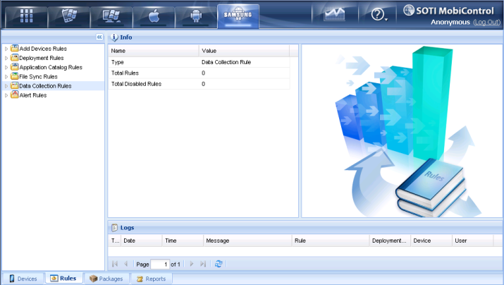

MobiControl uses rules to simplify the tasks of device management and configuration. See Below for a description of each rule.
Add Devices Rules
  1. Create an add devices rule.
    An add devices rule allows you to configure the settings that MobiControl uses to set up and communicate with your devices. These settings include: the device group to which devices are added, how often the device is to check for updates, and the parameters to be used for remote control sessions. Please see the Adding Samsung Android Devices page for detailed information about creating an add devices rule.

Deployment Rules

Application Catalogue Rules

File Sync Rules

Data Collection Rules

Alert Rules
